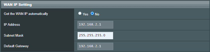

Solution:  The modem control WebUI sits outside of the router subnet (this gets complicated if you use a large subnet).  Internet data is sent via the gateway address, but control data uses that "reverse" channel to talk to the modem.
So on an Asus router it looks like this:
All internet data still goes the to ISP gateway, it's only that modem WebUI that goes to this address

I created that image for the response, and it's incorrect - the "IP Address is that of the WAN port and could be anything in the subnet - I used to use 192.168.2.10 not 192.168.2.1 which is the modem WebUI address and so would conflict!
