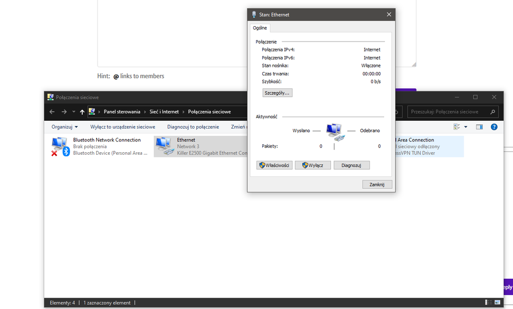

If you mean this then suspiciously i have no traffic registered for some reason. First time im seeing something like this

That looks very suspicious - I have to admit I was thinking you might get a speed below 1gb/s but not zero!
Try a different Ethernet cable, though I would not be surprised if that makes no difference.
Do you have an Ethernet switch available or even an old router with multiple Ethernet ports? There have been cases whereby the autonegotiation of speed between certain devices fails and putting a switch between the two devices allows them to function.
