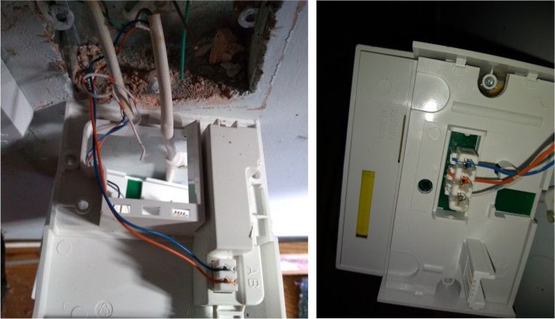

Till I retired I worked most of the time in an office built on the side of the house. BT moved the master socket into my office so that the router was nearer my PC, but leaving of course the bog standard phone socket there. However for some unknown reason the wifi signal into the rest of the house has become very intermittent recently though I get a satisfactory 65 Mbps in my office. I've tried various TP-Links which are pretty useless, so we've come to the conclusion it will be better to move the router back to the hall. Unfortunately plugging in the obvious dual filter/phone gadget into the hall socket does not work, presumably because BT have just wired this as a "junction box". Hence my query, wouldn't life have been much simpler if the master socket had been ethernet dual with pnone? Hope this makes some sense. And thank you for your interest.
Does the master socket have 2 sockets, one for phone the other for your router?
If, as I suspect, it does, then it is a filtered socket which means broadband is not extended to your extension socket.
Simply transfer the 2 wires that are currently terminated on pins 2&5 of the removable faceplate (that go to the extension socket) to the data extension terminals instead.
I am grateful for your reply, however . . . In an enlightening, nay exciting day, I learnt a smidgeon of knowledge about BT sockets by delving into the many YouTube videos and found this suggestion of swapping two wires to AB. However as you can see there are already two wires in these slots, so I haven't ventures along that route - but please tell me if I'm wrong.
