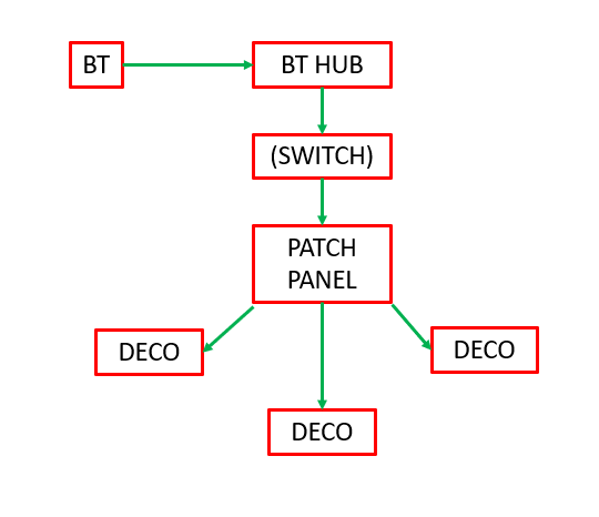

Still a bit confused by "switch panel"?
If all eight rooms are wired then I'd expect an eight port patch panel in the cupboard. This is not a switch, just a passive connection panel. I suspect this is what you have as you say it's labelled for each room.
If you want to feed more than one room then relocating the Hub won't work, you'll need it in the cupboard to feed the panel. If you want to feed more than three then you're right, you will need a switch as well.
I also have little knowledge of the black disc but seem to recall that only one can/should be attached by ethernet. You would probably be better researching WAPs (wireless access points) that fit with your needs. If you were to buy a switch with PoE (power over ethernet) then many WAPs can be powered with just an ethernet cable without requiring their own AC adapter.

I think I'm getting this now. it would be routed as below (the switch if I needed additional points/rooms patched) running to a mesh e.g. TP-Link Deco for the extremities of the house.
Would this be the correct thing to do?
