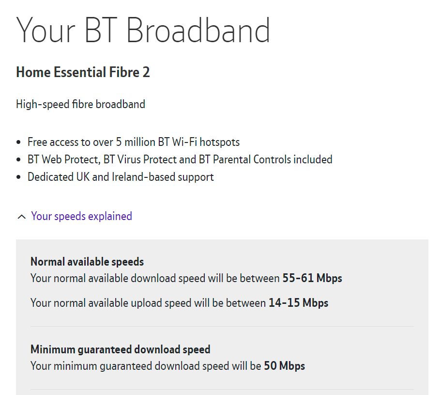

My BT section shows
Home Essential Fibre 2
(high speed)
(this connection is part of the dwp supported essentials package for people on certain benefits)
I presume its 80/20 (or around 67/15 throughput) which it seems to have been for years, but my modem is syncing at half of the supposed upload. There are some model/dsl modulation settings I can change but I'm loathed to mess with it unless I get some concrete feedback on the right settings for me to change. I have a disability, and need to open the main door remotely so need the internet downtime to be minimal.  Of course, it could be that BT have halved the upload without my knowledge. If anyone can advice me I would be very grateful

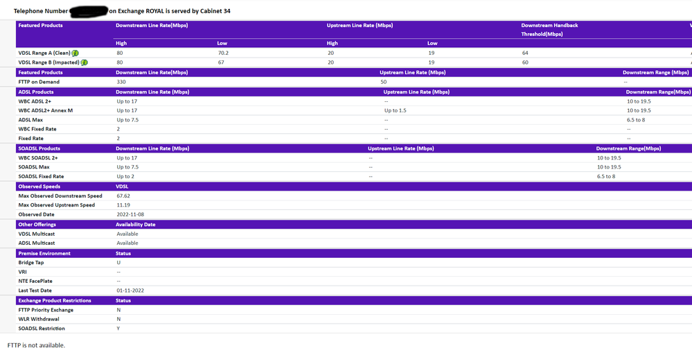

Thank you but that's not how my setup is connected.  The DSL-X73 is a combined DSL router and modem, I do not use the supplied BT Router.
Is there anyone who can look at my account and see what my connections sync speeds should actually be?

try entering your phone number and post results  this will show your expected speed range
2,967 Views
Message 5 of 5
Re: tp-link x73 dsl modem router
Thank you  imjolly, Here's what my account says,
I'm pretty sure my upload is about 17 on the BT supplied router but I'd have to plug it back in to verify.
