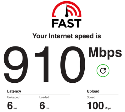

I recently had FTTP and BT 900 installed. I appreciate that speed tests vary and there can be a considerable difference in results based on everything from device connection to computer processing speed, but I've come across something I'm finding it hard to explain.
As a Sam Knows reporter, my Whitebox has been chucking out some pretty meaty detail about how the connection is actually performing, and it's on average reporting at around 900.
Again, using Fast.com and SpeedTest.net, there's another element of difference - which I totally understand - but pretty much inline with or around the 900 mark.
Yet when I run a speed test on BT's Wholesale site, I'm getting speeds that go way beyond what the line is profiled for.
https://speedtest.btwholesale.com
Whilst my ping rate is pretty consistent with other tests - the download and upload are consistently reporting considerably higher - 1878.08 Mbps Down / 191.58 Up.
Is anyone else getting this?
I'm running the test on a 2019 MacBook Pro, through Safari and ethernet connection directly to the router.
I wondering if perhaps the speed test is reporting what the line is CAPABLE of handling, rather than what it's been set to deliver? It doesn't explain that that is the case, but I could see it being pretty misleading if you're being asked to check your speed through it.
If this is the case, it seems strange that I'm getting under 900 on a profile that is supposed to average 900.
I tried running a test using my 4G data, and that does look to be consistent with what I'd expect.
Anyone else getting this?

@DaveSwan Yes, the BT wholesale checker has always been way off for me too. I don't use it for this reason.
The BT Wholesale checker regularly reports over 3 Gbps over ethernet on both my Macbook Pro and iPad Pro. It's the same result no matter what browser I use. I do not have a Windows computer to be able to crosscheck.
So you are not alone, but I don't know the reason why it does this. Speedtest.net and Fast.com report realistic speeds, so I tend to stick to those.
