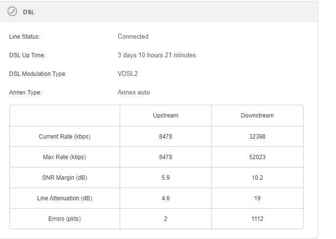

Hi TimCurtis , thanks for your reply, I am not sure what info the connection stats would show, if you could give me an example of one of the data in these stats, in the meantime I have found this info which might be what you was asking for?

At some point DLM has taken umbrage and has lowered your speed to 32Mbps (from a possible 52Mbps) in order to provide a stable connection.
You possibly upset it if you made a lot of connection/disconnections whilst setting up the TP Link whilst connected to line. Give it a couple of weeks for DLM to restore your speed.

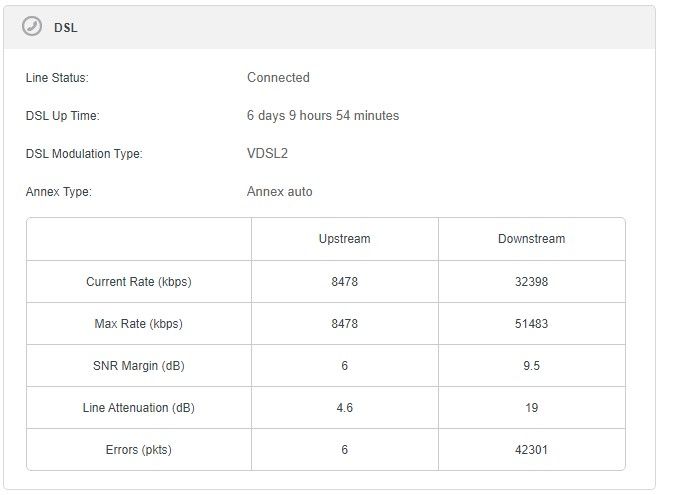

Another concern of mine is the amount of Errors (pkts) I can see on the stats from my router, yesterday it stated 1112 errors and today its now 8310, are these usual or excessive?
I will continue to monitor but not reboot or amend settings on my router and see what happens over the next couple of weeks.

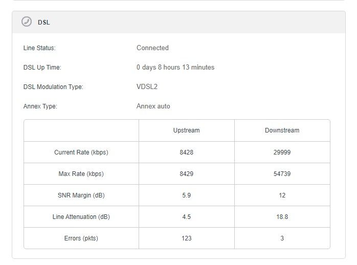

I am also confused about why my router or line has reset itself, I was watching and for nearly 7 days it was same speed although the number of errors were slowly increasing. Router stats 28 July.jpg
Then this morning at 1AM it appears to have restarted or BT has done a reset as I have a new IP address and the UP time now only shows 0 days and 8 hours?
The downstream speed has also decreased by quite a bit.
This is very annoying as I was watching to see if the DLM improved my speed and not rebooting or touching anything as you had asked, however BT decided to reset my line and now I have to start all over again 😞 Is this going to be the norm......
