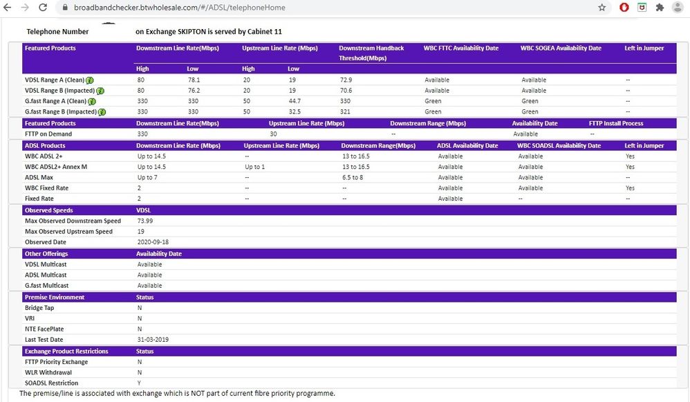

Now I check my package again and see
FIBRE 1 Your download speed range 69Mb - 73Mb
Upload speed range 17Mb - 18Mb
Your Stay Fast Guarantee 65Mb
so I do't know what the hell is going on anymore.
Maybe I was checking offers based on my current line speed.
4,005 Views
Message 13 of 23
Re: BT Fibre 1 Hub 6 Repeated disconnections - going on for 7 days now
Go to solution
post hub stats  advanced settings then technical log information
also enter phone number and post results  remember delete number but leave exchange and cab
