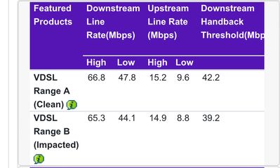

Hi @imjolly  and @iniltous thank you both for this.
Im not the most technical but when I enter my phone number in here it says what I’ve put in the picture. I’m not getting anywhere near 60mb+ am I reading this right? In fact I don’t even get the low speeds it says….but I may be in the wrong bit so your help would be appreciated.

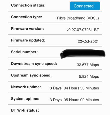

Go to solution

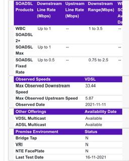

can you post rest of the result apart from the notes below results
what about hub stats
can you check for line noise  dial 17070 option 2  should be silent and best with corded phone

@iniltous @imjolly  I think that’s all info attached now.
You asked what it showed for BT wholesale as a new customer and interestingly their estimate is the same as the other provider and far higher than I get right now.
