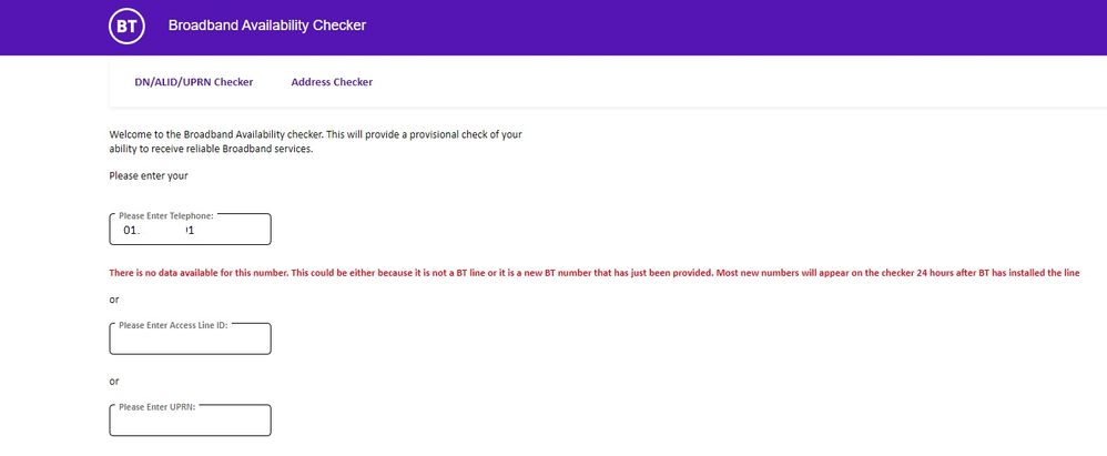

Where are you searching on Kitz? Do you mean Codelook?
Was you prospective purchase the site office/show house?
If you enter a non BT number in the checker, this is the result you get
