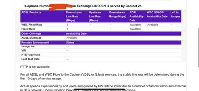

Good afternoon. A bit of an update. You’ll probably tell me off for being impatient!
I have been connected today and a couple of issues / observations arise. I have now done a DSL check (yes I know I should wait until Friday but I did one out of interest anyway). It produced the following result
 now it makes no mention of FTTC but perhaps that will come on Friday? I was more hopefully because it is now saying served by cabinet 25!!! Does this therefore suggest that I am connected to cab 25 rather than the exchange directly? If so presumably that’s good news even though currently it still makes no mention of FTTC?
the second issue is that I can’t actually get the broadband to work. The orange light is on. It goes through a cycle of flashing green then it goes blue for about 15 seconds before going orange. Could this just be because the line still isn’t connected? BT had said it could be any time up midnight but I then got a text from them a couple of hours ago saying everything is live so should be working. Am I best to call BT in the first instance regarding  that?
Thanks, Nick
4,106 Views
Message 50 of 57
Re: BT saying Fibre isn’t available at house I’m purchasing
Go to solution
Certainly looks as though you are connected to cab25 but your broadband possibly hasn't been activated yet. Wait until tomorrow at least to see if it connects and then unfortunately until Friday to see if the checker updates. Although it doesn't hurt to check every day just in case.
