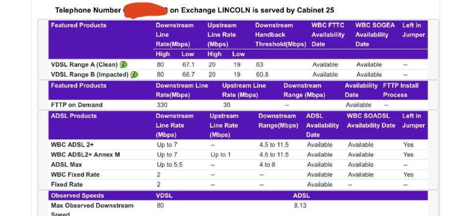

Good afternoon.
Some good news!  The engineer came out on Thursday and struggled to fix the issue at my house.  He went to the exchange and replaced the equipment and it sorted the problem out.
Even better news is the DSL checker is now saying this line does get FTTC and is connected to cabinet 25.
DSL.jfif
I have just got off the phone and their system now also says that I can get fibre so they have upgraded me.  Not got an exact timescale yet but fingers crossed it was all sorted.
So in conclusion it looks like I was connected to cab 25 the whole time and there was some sort of error with the checker suggesting I was an exchange only line.

Glad you got it sorted @nickshaw11 and thanks for the update. Cheers @pippincp , Salvation Army please if that's  ok with you.
You should get pretty much the maximum 80M speed from fibre
Edit :@nickshaw11  can you post a screenshot of the lower part of the checker screen where it shows max observed speed please, I think you have already been upgraded and are getting the full 80M

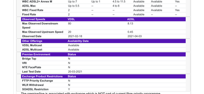

Hi. Here is a screenshot of the lower part of the test result:-
 thanks
Nick
2,973 Views
Message 57 of 57
Re: BT saying Fibre isn’t available at house I’m purchasing
Go to solution
Ok, thanks.
On your previous screenshot the max observed VDSL speed was shown as 80 but the date was  cut off. I wondered if it was observed today but unfortunately not, it was the 18th Feb so must have been at your previous address. The max observed ADSL speed is dated today so you haven't been upgraded yet unfortunately. Hopefully won't be too long.
