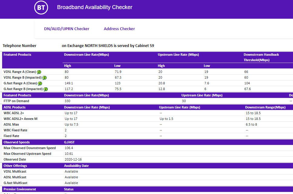

I have G.fast. When I look at the Broadband checker, it says that available speeds are between 149Mbps and 123Mbps for a clean line and between 117Mbps and 75Mbps for an impacted line.
When first installed by the Openreach engineer about 12 months ago I was generally connecting at about 134Mbps, so clearly a clean line. Now the Smarthub is reporting that it is connected at 105 Mbps with a maximm possible speed of 108Mbps so clearly impacted.
As nothing has changed at my end either in terms of wiring or devices connected, what causes a clean line to become impacted and can anything be done about it?

Just for the sake of comparison, and in case it helps, here is an extract from the BT Broadband Checker showing the speeds which should be achievable.
