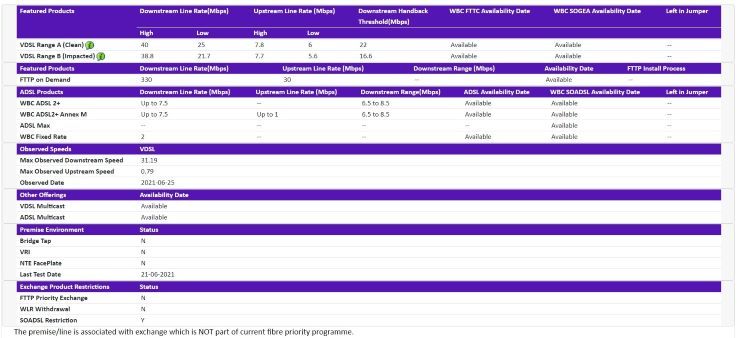

About two weeks ago when we had warmer days, our line dropped 6-7 times in a row and then after the disconnects our download speed dropped from 31Mb to 16Mb, upload speed from 6Mb to 200Kb (DLM kicked in?). The line has not disconnected since but with the upload speed like that and latency that has gone up significantly, internet is unusable for some things, like sending photos, email attachments and so on.
Openreach also visited again just after the last set of modem disconnects and told me that they are going to replace the last piece of cable, 20 metres from my house to my master socket. They said they don't know if the fault is there, but want to replace it.

are you using the master socket?  have you tried using test socket with filter to see if that improves your connection or even your attainable speed.  At present your connection speed is just about your attainable suggesting your connection is as good as line capable of and within your expected speed range from dslchecker

The DLM will automatically restore your connection speed provided you can get a stable connection for at least 4 weeks and maybe longer unlike ADSL which was only 7/10 days

If you are now connected to test socket with filter has it improved your attainable speed not necessarily your connection speed.  At present your connection speed is about your attainable speed suggesting you are getting as good as line can handle.  You are very unlikely to get a DLM reset until you can show you have any faults fixed and line now stable
