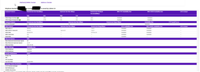

Bit of a long story but i was with Sky for FTTC, but on a cabinet much further away from my house. Due to the speed issues and reliability problems I was having, I was moved to the cabinet 24 which is much closer to my property. This was done via cease/reprovide. The cease has happened with Sky now (so i currently have nothing apart from mobile data), but they wont do a re-provide due to the ordering issue i mentioned previously. Im hoping to get this fixed then switch to someone like BT as sky haven't been great so far. Anyway, here's the output of my address:
My next door neighbour's output has the VDSL availability listed at the top of the output and he's on the same cab (24).

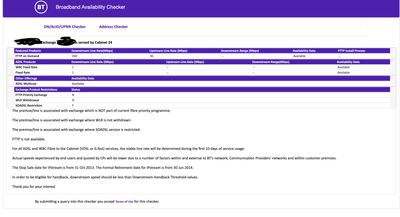

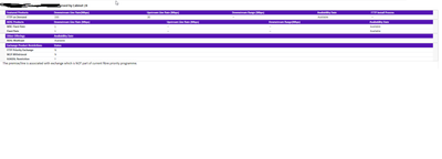

Ok, more information for you.  Cancelled Sky and am now trying to go through BT for a FTTC service - they are saying that there's no capacity on the box (due to my record being screwed up) - i spoke with my neighbour who is on the correct cabinet and he has VDSL available. Screenshots below:
My next door neighbors record (cab24):
My record (cab24):
Obviously my record is totally screwed up just looking at it, and is preventing me signing on with BT. Can this be fixed, does anyone know please?

Until you have an active phone line with BT Retail, the Openreach database will not be updated to reflect the correct routing.
Once you have a BT Retail phone line, if you enter your number into the form, you should see the correct availability information.
The data for your neighbour does not make sense, as the observed speed was 80Mbs, but the expected maximum is only  30.3Mbs, so something is not right with the database.
