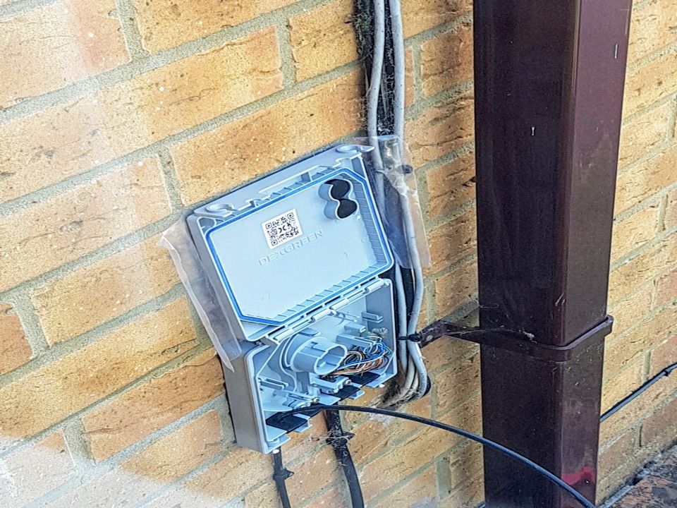

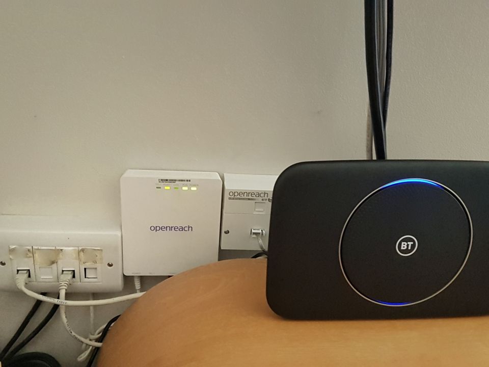

Are you sure you have FTTP.  Do you something like this in your home
If not then you have FTTC - fibre to can and copper to your home

Hi, thanks for replying so quickly.
We definitely had FTTP installed - got a new CSP and ONT put in just last week (see photos)! We ordered "Fibre 2" because it was only an extra £2 a month compared to our previous package.
