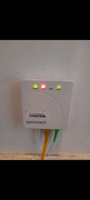

Getting there... the internal box is quite different to what I was expecting.  It's tiny.

Yeah i was surprised myself when they installed my ONT box, i was expecting bigger.
However performs amazing for gig service.
Good luck on your install, and enjoy your new broadband speds 😄

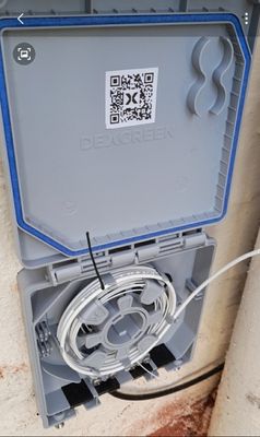

Another cheeky picture for anybody interested, the box outside.
