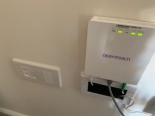

 these are what is installed if anyone could offer any guidance on whether I have wired it up wrong and how to wire it

The grey lead should go to the red WAN port on your hub, if you don't have a hub with a WAN port, it won't work.

Thanks very much, will wait for the new box to be delivered then
