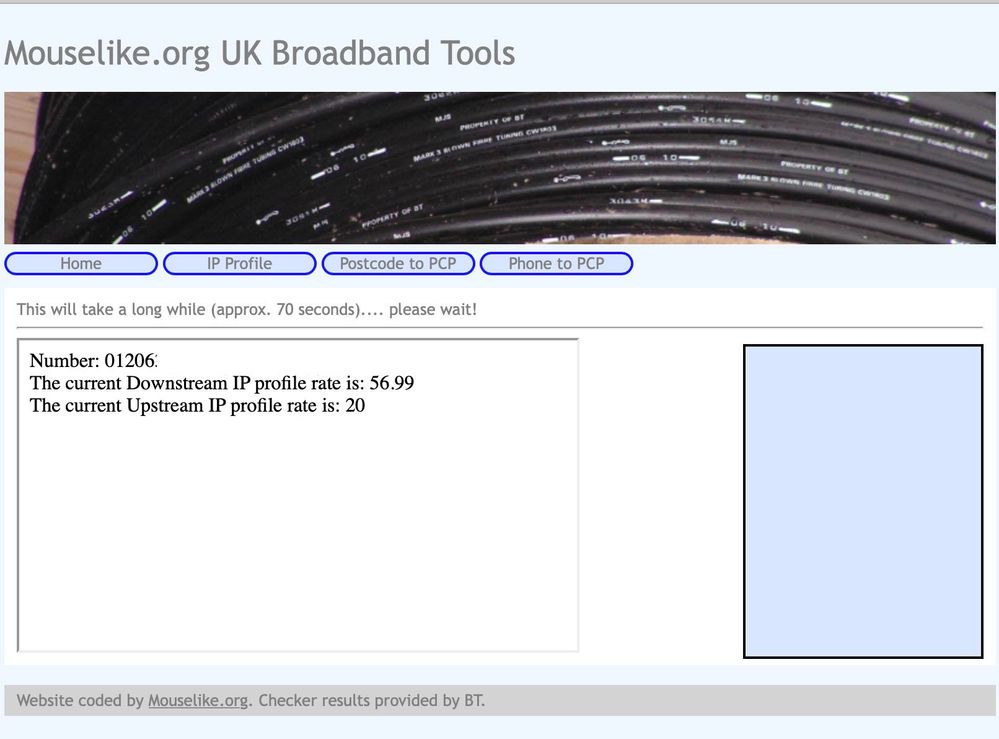

Due to my downloads now hovering around 50MBps I went to the Mouselike.org and saw my IP Profile is set to 56.99
I then went to broadbandchecker.btwholesale.com and see my hardback thresholds are 65/62..
I know I might have to wait for a week or something for the line to 'settle' but as I understand I'll never achieve higher than my IP Profile 'cap' my question is (please);
Will my IP Profile raise itself or does it need resetting by someone somewhere?
I'd be grateful for advice otherwise I'll be checking every week and never getting anywhere if I should have asked for a Profile Reset 'somehow'..

your profile is based on your connection speed so if your connection speed can recover then your profile will increase.  it is the speed that decides the profile not the other way round

from the checker results you have a 58.5mb down connection speed and 20mb up speed which should be enough for working from home  all the line problems you have had have resulted in the DLM taking action to try an stabilies tour connection by increasing your noise margin resulting in lower speed.  unfortunately as you are using a modem then unless that is unlocked you are are unable to provide the normal meaningful stats
you need to try and maintain a stable connection with no resets or drops in connection and then DLM will start to lower noise margin and increase speed but could take a few weeks

For now then I am grateful to you for explaining the IP Profile will return to a higher level automatically and there is no gainful action I can take and I should see it at a higher level than the downstream handback threshold if all goes well.
