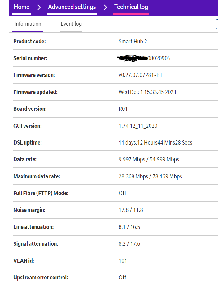

Hi
I have been on fibre 2 for a few months (returning customer) and whilst the speed I get is good (54.999Mbps DL and 9.997Mbps UL) however it is much lower than I had with BT 18 months ago when I was on the same package, same line but much older BT home hub router
I rang BT customer support who said as this is above your minimum bit rate guarantee then there is nothing that can be done (fair enough he had a script to read) and that the speed you have is the maximum fibre 2 can provide (umm not so true), I also spoke to the technical person who just confirmed that BT makes a decision on how many users are connected to an exchange and then allocate the throughput accordingly and that decision cannot be changed and that in his opinion was my speed is not limited - also he told me that my previous attainable speed was irrelevant as that was in the past - so no joy there
My smart hub2 router is connected to my master socket, I performed a clean line test and it is completely silent - I live in a village and luckily I can see my local exchange from my house so thought I would be closer to the 67Mbps/20Mbps but maybe there is now a connection issue between the exchange and my house that I am unaware of?
Here are my line stats and also router log (11 days since last power cut 🙂 storm season)
Does anyone have a view that could help solve my mystery?
@DavidM I saw a similar post where you had a view maybe you could help? Has my line been artificially banded incorrectly? Or is this the best it can get? maybe the noise stats wont support anything better?
Much appreciated

I don't think you are in banded profile more like you have possibly made a change or renewed tur broadband package and somehow you have been moved to fibre 1 55/10 mb connection.  can you check MYBT and make sure your package still shows as fibre 2.  if it does then post back as you probably need mod help

Hi @Tomlaw welcome to the community and thanks for posting your router stats. I'm sorry to see you're not getting the most from your broadband connection.
At a glance, it looks like you've been incorrectly put on a 55/10 profile but I would need to do more checks to ascertain what is going on. I'll send you a private message so you can send over your details and I'll be happy to help.
The 'technical' person was talking total nonsense.
The location of the exchange is totally irrelevant as your broadband is delivered from the cabinet not the exchange.
Much appreciated
Your line appears to be configured as Fibre1 rather than Fibre2.

Thanks licquorice
"The 'technical' person was talking total nonsense."  It was one of those call centre conversations that was quickly going nowhere other than me crying in frustration and I guessed he also had a script 🤥  I was originally  told it was due to some kind of a security issue that the speed was as it was which really was nonsense . Also the first guy didn't want me to talk to anyone else so I imagined he just got a friend in the call centre to just pretend 😁 or am I too cynical
The location of the exchange is totally irrelevant as your broadband is delivered from the cabinet not the exchange. That's interesting I hadn't realised , but the cabinet is  just on the roadside outside the exchange so only a few extra meters  further away
Regards

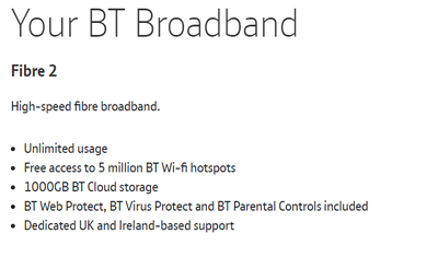

Message 7 of 12
Re: Is my broadband fibre 2 speed artificially capped or banded
Go to solution
Hi imjolly - defo fibre 2 for payment if not for speed

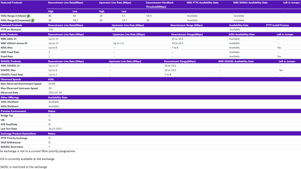

Hi @Tomlaw,
I gave your mobile number a quick call, I'm sorry I wasn't able to speak to you today.
I've checked and it looks like the speeds have increased at the moment I can see the connection speed is around 68 Mbps.
How are things at your end, have you noticed an improvement?
Thanks,
