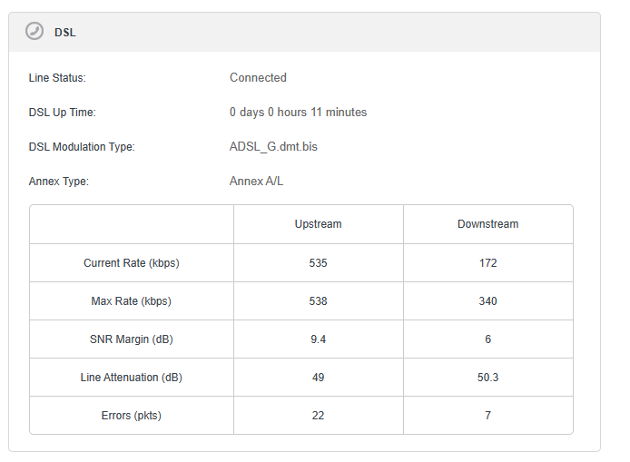

I bought a new BT phone a couple of weeks ago and it seemed to did a trick although the speed on both upload/download is not at 100% what it was.  The connection is still not solid. A couple of days ago, I asked my sister to do a quiet line test as you have always advised me and she said it is fine.
And then the connection got worse in the past few days, keep getting disconnected and resync at slower speed to the point that it could not sync last night. At that, I tried the phone method again and it did the trick but this time, the speed is much slower. Here is the stats:
So this problem has been going on for 2 months now, I think it is pretty fair for me to call it a day and request a termination of my contract with one of two lines. Because BT can not fix this issue for me with 4 different engineers.
