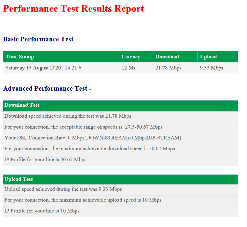

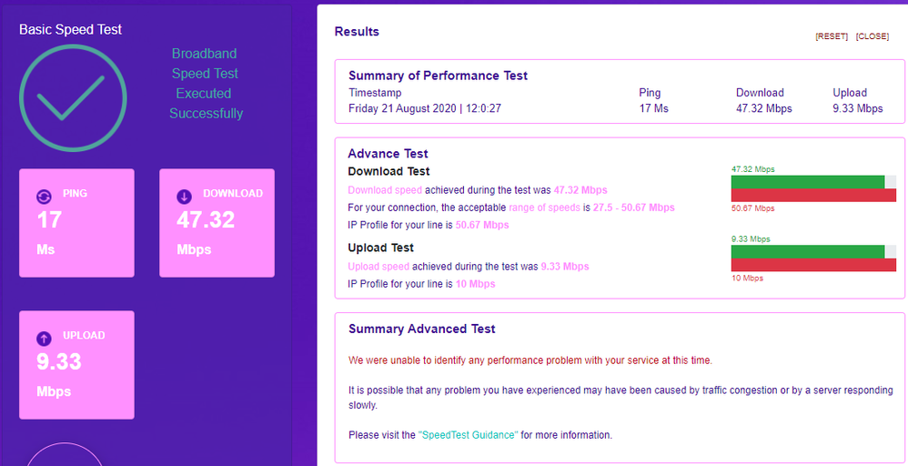

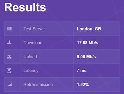

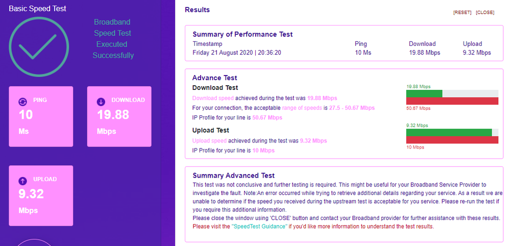

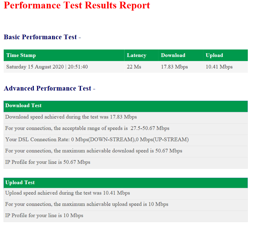

I'm glad the team is monitoring my line this weekend. Speeds have been pretty bad, as well as packet loss. Tried a number of different services. They will def see something for sure.
C:\Users\Scott>ping -4 google.com -n 50 -l 1452
Pinging google.com [216.58.198.174] with 1452 bytes of data:
Reply from 216.58.198.174: bytes=68 (sent 1452) time=9ms TTL=116
Reply from 216.58.198.174: bytes=68 (sent 1452) time=11ms TTL=116
Reply from 216.58.198.174: bytes=68 (sent 1452) time=15ms TTL=116
Reply from 216.58.198.174: bytes=68 (sent 1452) time=14ms TTL=116
Request timed out.
Reply from 216.58.198.174: bytes=68 (sent 1452) time=10ms TTL=116
Reply from 216.58.198.174: bytes=68 (sent 1452) time=16ms TTL=116
Reply from 216.58.198.174: bytes=68 (sent 1452) time=19ms TTL=116
Reply from 216.58.198.174: bytes=68 (sent 1452) time=22ms TTL=116
Reply from 216.58.198.174: bytes=68 (sent 1452) time=35ms TTL=116
Reply from 216.58.198.174: bytes=68 (sent 1452) time=24ms TTL=116
Reply from 216.58.198.174: bytes=68 (sent 1452) time=32ms TTL=116
Request timed out.
Reply from 216.58.198.174: bytes=68 (sent 1452) time=21ms TTL=116
Reply from 216.58.198.174: bytes=68 (sent 1452) time=18ms TTL=116
Reply from 216.58.198.174: bytes=68 (sent 1452) time=8ms TTL=116
Reply from 216.58.198.174: bytes=68 (sent 1452) time=13ms TTL=116
Reply from 216.58.198.174: bytes=68 (sent 1452) time=17ms TTL=116
Reply from 216.58.198.174: bytes=68 (sent 1452) time=12ms TTL=116
Request timed out.
Request timed out.
Ping statistics for 216.58.198.174:
Packets: Sent = 50, Received = 46, Lost = 4 (8% loss),
Approximate round trip times in milli-seconds:
Minimum = 8ms, Maximum = 35ms, Average = 13ms

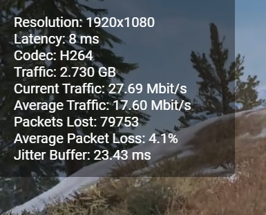

Tried to play some stadia but:
Unusually it was also bad during the day today on Saturday. It is the weekend though. Speeds were normal at 48-49mb down about 2AM onwards Sat morning.

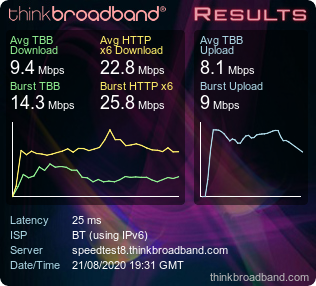

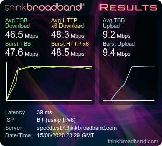

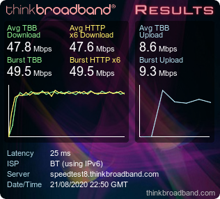

It's now 12:30AM, offpeak (using thinkbroadband because I don't want to overrite the last BT wholesale one):
Everyone must be going to bed.

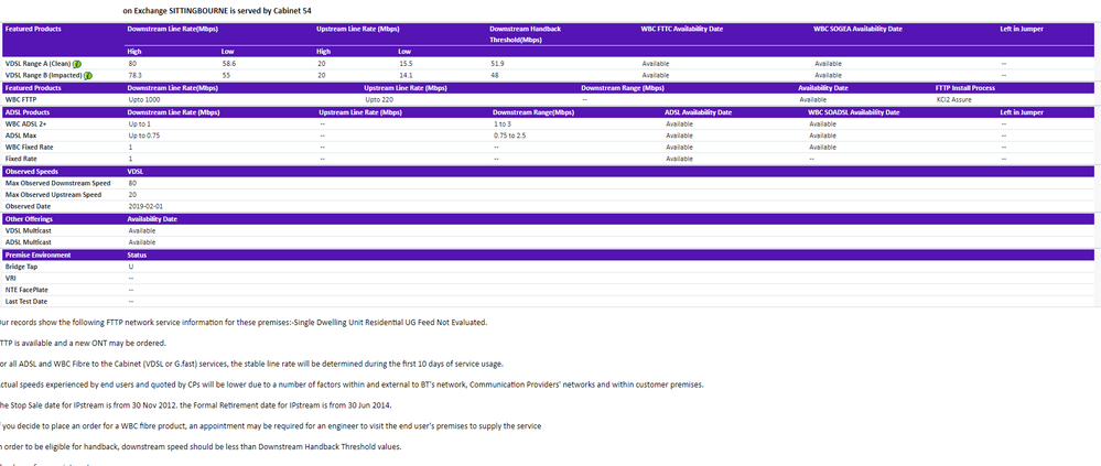

Just an update and some(lots) of questions for you guys. So the SVLAN reports at the exchange came back saying no congestion, they monitored it for 48 hours last Friday and speeds were just as bad as today. Line tests didn't reveal any crosstalk or any problems that could be picked up on remotely.
My router stats show a full sync speed of 55mb and that is the package I'm on.
I have an engineer booked for next week anyway, but I don't think it's going to change anything, I guess it's needed to be able to progress this further though and he can check my wiring etc to give BT more evidence I guess.
So the idea is to find out why I'm getting bad throughput speeds at peak times, if I'm not on a congested SVLAN.
Just for some info, all speed tests are done via ethernet (the one supplied with the router) and I live alone, so I know nothing else is using up bandwidth, I checked the router stats and disabled Wifi. Connected via test socket using the microfilter supplied. No phones are connected.
I did another quiet line test at the test socket and this time it was actually quiet, no noise at all.
So first the router stats, I actually heard somewhere that the noise margin on the lower Fibre 1 package is normally set at 10db due to the decrease in sync speed needed, can anyone confirm this? The noise margin also doesn't seem to either go below 10db or above 10.9db, no matter what really, just floats around 10.5 normally. Also for what it's worth, when I was with TalkTalk on their top fibre package, the target noise margin was 3db and it was 3db, didn't go above 3.9db. I don't think there is noise on the line.
Another thing is that for some reason it says BT Wifi activated, even though I opted out like 3 weeks ago. It does say it's disabled on other pages though, not sure why this page doesn't update, I also did a WiFi channel scan and did see a hidden SSID with the same channel and signal strength as mine, I'm also the only one on BT in my block of 6 flats. Could a mod confirm if BT Wifi is actually disabled for me? I know it's supposed to only use a very small percentage of bandwidth, but I don't want it on and I did turn it off on the BT.com website.
When I first reported this congestion problem via live chat, the guy on the other end did some tests and said he had problems connecting to the router and put an order in for a replacement, for some reason the despatch date is 2nd Sept and that was ordered on 31 July. I wonder if there is some hardware issue in the new hub and they are waiting for the new versions, could just be a delay in sending it out though.

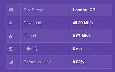

Here is the speed tests done at 12PM Friday. So ideally these should be congestion free and they are, getting full speeds, no problems at all:
1598007595825925955
I also did a couple trace routes, to see if there is any difference between 12PM and the later tests:

And here is the speed tests done at 8.30PMish Friday. I mean to me, if I get perfect speeds at 12PM and then the following at peak time, this is clear congestion, no? But what can I do if BT is saying the SVLAN is not reporting congestion?
It's pretty unlikely that the congestion is at the cabinet isn't it? Is there anywhere else that congestion can effect after the SVLAN? I would of thought anything after that would be picked up on instantly though and this problem has been going on for weeks now. Months, if you include TalkTalk also.
Peak time speed tests 8.30PM:
1598038317229853655

So pretty clear and well below acceptable speeds at peak times.

Something else I noticed that is strange is that in in the BT wholesale speed test report it says "For your connection, the acceptable range of speeds is 27.5-50.67 Mbps" It never used to say 27.5, this has been added after repeated tests, it used to be a lot higher. So this seems to update itself from previous tests. I'm also not sure why 27.5 is acceptable, the DSL checker shows a downstream handback threshold of 48mb, even on an impacted line, if BT think 27mb is acceptable, then they must think going from 50 to 27 during congestion is also acceptable, that's a 40%+ decrease in throughput speed, do they really allow that kind of decreases during congestion. I would of thought 20% would be enough for them to find an issue and I checked Ofcom stats and it's usually only like 10% or less of a loss during congestion on average. This range also differs from the range advertised when ordering the package and BT are supposed to be applying the new Ofcom rules that state the advertised range of speeds should reflect peak time congestion (maybe they didn't have this data yet though I guess).
The DSL checker is actually wrong though about FTTP and my status, although our area is FTTP ready, I'm an MDU not a single dwelling. Not sure why it thinks I'm single dwelling, maybe because I have my own outside facing front door. Currently trying to get Openreach to get permission from the freeholder to install FTTP, but that's another story and will most likely take months as Openreach said there is a delay at the moment for contacting freeholders. They have created a full record though and said it will be done as soon as possible. The DSL checker does show an observed speed in 2019 of 80/20 though, this was before I had problems.

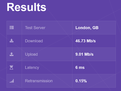

So it's now almost 12am, people should be going to bed and things are pretty much back to normal:
1598050201684504455
The only differences in the trace routes between the congested times and non congested times is that when I had congestion problems, the trace route introduced the following hops:
peer2-et0-0-1.slough.ukcore.bt.net [62.172.103.202]
peer3-et-7-0-4.redbus.ukcore.bt.net [62.172.103.252]
These no longer appear when I do the tracert again. It just uses
colindale.ukcore.bt.net [213.121.192.26]
telehouse.ukcore.bt.net [109.159.252.94]
and they did not appear in the earlier non congested tests either. Could be something.
