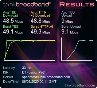

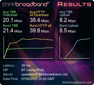

So I did a test on thinkbroadband, that allows single threaded and multithreaded tests. This was the result,
1596832976532626855
The single threaded connection is getting throttled back.
It seems like congestion and maybe somewhere in the exchange it is seeing lots of retransmissions and is pulling back single connections? I have done the same TBB test during the day and both single threaded and multi threaded download speeds are the same, so it is purely peak time congestion problems. I live alone, so I know for a fact I only have the one ethernet connected.

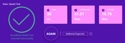

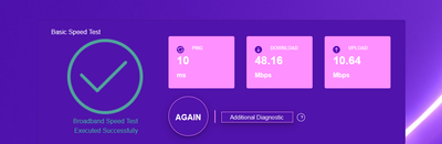

Here is the BT speed test at the same time as the above TBB test:
It does show a high ping. But as it uses multiple TCP connections, it can reach the 41mb speed.
Here is one from 4PM with lower ping and higher speeds:

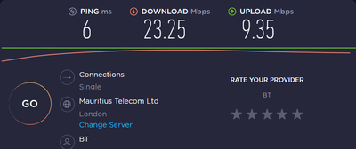

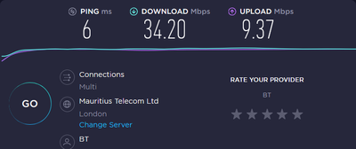

Just to double check, I used speedtest.net and did a multi download and single download test. First is the multi download test:
Now I understand that a single threaded download can be slightly slower, but on a non congested line, it should manage the 40-50mb and it does in fact during off-peak times.
Both are actually below my estimate, but it is peak time. I basically need the minimum speed guarentee of 40mb that I was told when I signed up and I have no idea what to do as it's only peak times that I have issues. Even a stable 30mb on a single UDP would work, I get 50mb during the day on all tests.

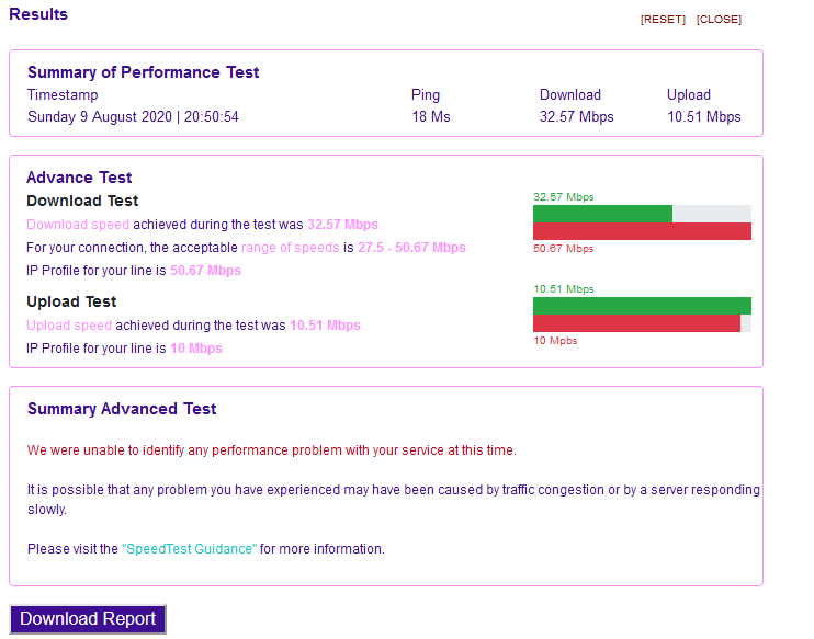

I just did another speed test using both the BT.com website and the BT wholesale speed test. Both of them fail the stay fast guarentee of 40mb when I signed up.
I only get bad speeds during peak hours. I live alone and have noone else downloading anything, I have checked.
The fault checker at first said that the speed was bad and then I continued to the next page and it said my speeds look great and closed the page. Really annoyed me.

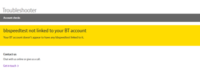

Here is some screenshots:

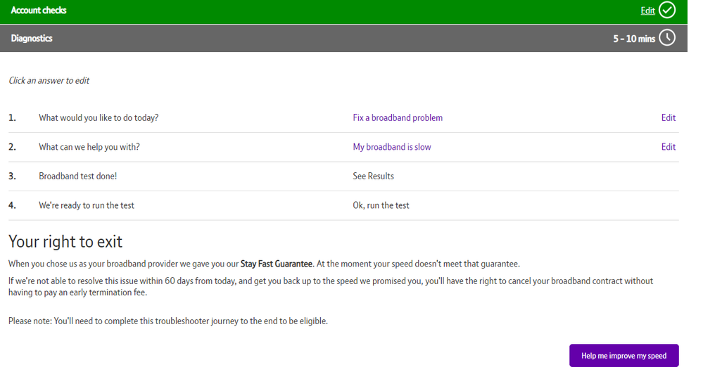

The first was the BT.com troubleshooter that clearly says there is a problem:
 Then I get this? And the fault goes green and says everything is OK and right to exit removed.

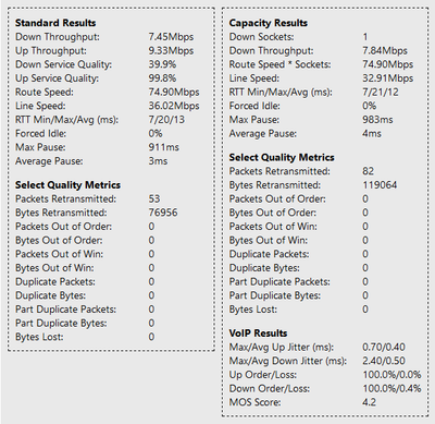

This is another test I found that showws the high packet retransmissions:

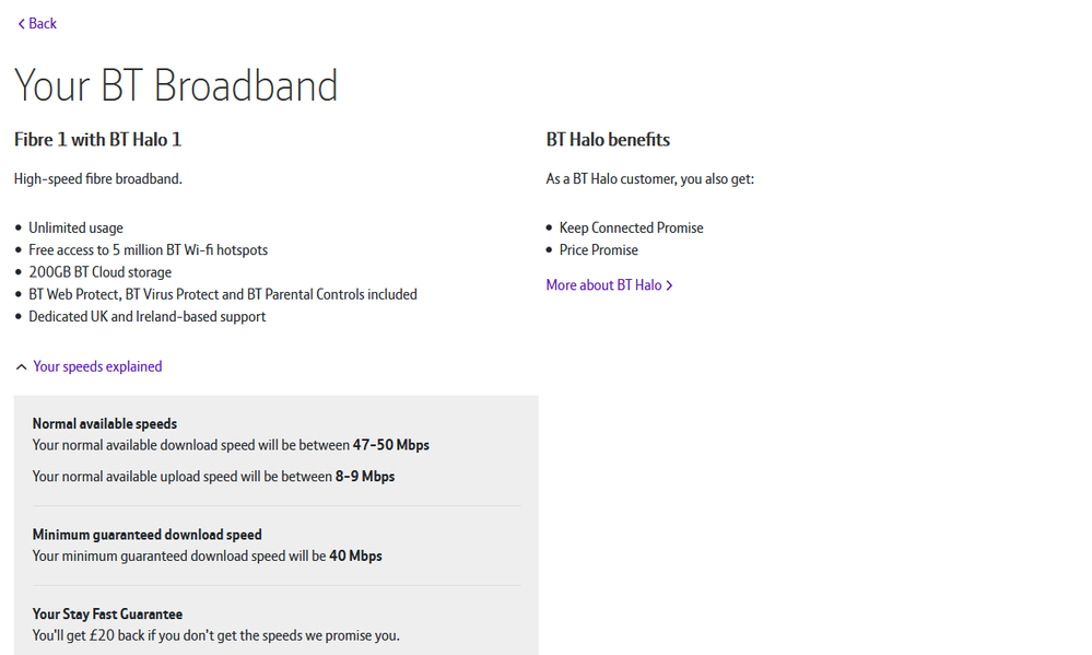

And here is the ThinkBroadband test:
1597004037586367255
