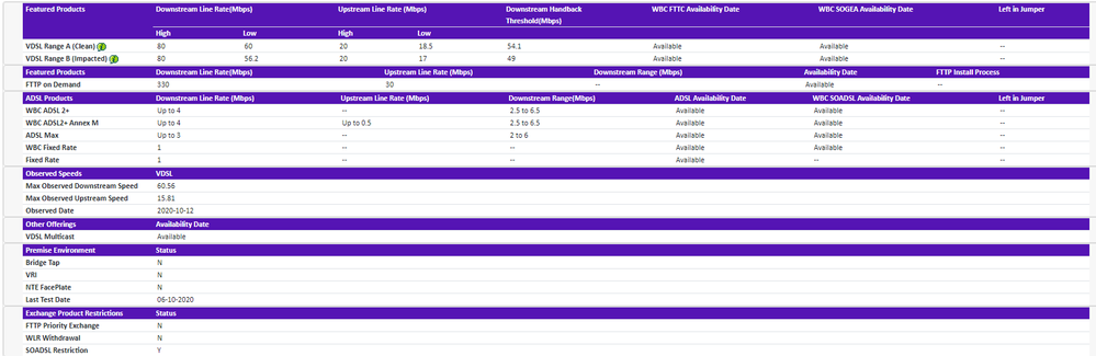

Did the above, here are the results:

Re: Router fault has caused DLM to reduce line speed by 50%. How can I get this reset quickly?
Something weird going on here, that shows you were getting 60M on Monday
That's right, 60mbit line speed monday (and tuesday).
Netgear router attempted to update firmware over night last night and bricked itself.
New tp-link router installed today after many attempts to unbrick netgear router.
Line speed is now 30mbit~
The new router is an Archer VR2800. Which has BT configuration out of the box (though I have tried setting up the connection manually). And plenty of people here seem to be using at full sync speed without issue. Besides the drop in sync speed the router otherwise seems very solid.
It is definitely not DLM or you wouldn't have a 3dB margin, I really don't know why the speed has dropped. Have you tried connecting the router to the test socket behind the removable faceplate of the master socket with a new filter.
your  attainable is only 30mb so as @licquorice   Says this has nothing to do with banding and DLM as that does not affect attainable speed
 when in test socket check you have dial tone and the line I see quiet with no noise
