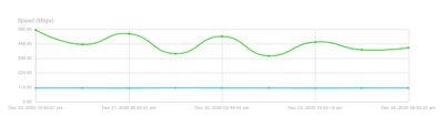

The speedtest built into Omada Cloud looks like this over the last week.
Could it be that my ONT box is quite old and even been onsite through a large refurbishment, i guess probably not but running out of ideas 🙂

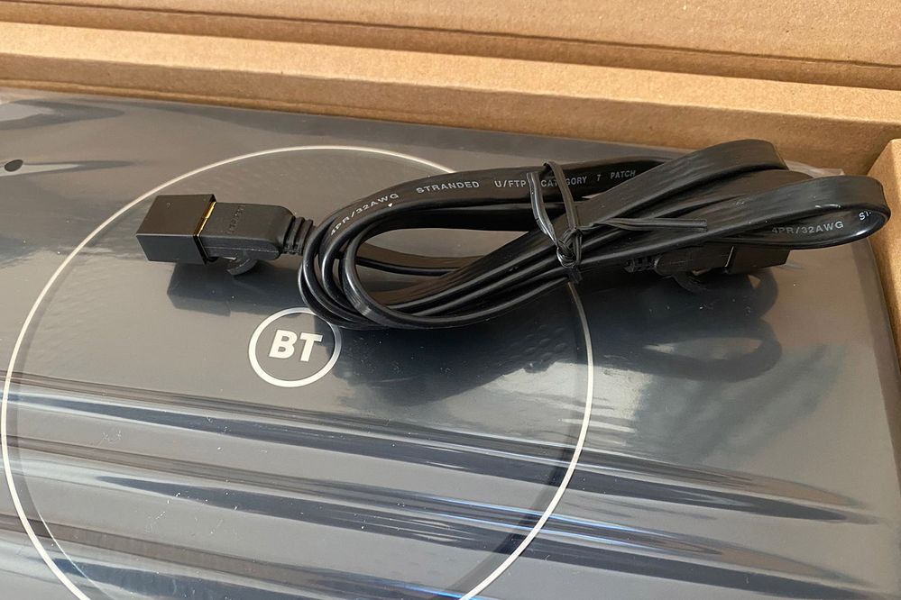

I bought a couple of those cables and it didn't change anything mate.
Sorry to be the bearer of sad news. 😋
It's now sat redundant with the Smart Hub 2. 😂
Honestly CAT-5e is plenty for 1Gb, trust me I have tried it.

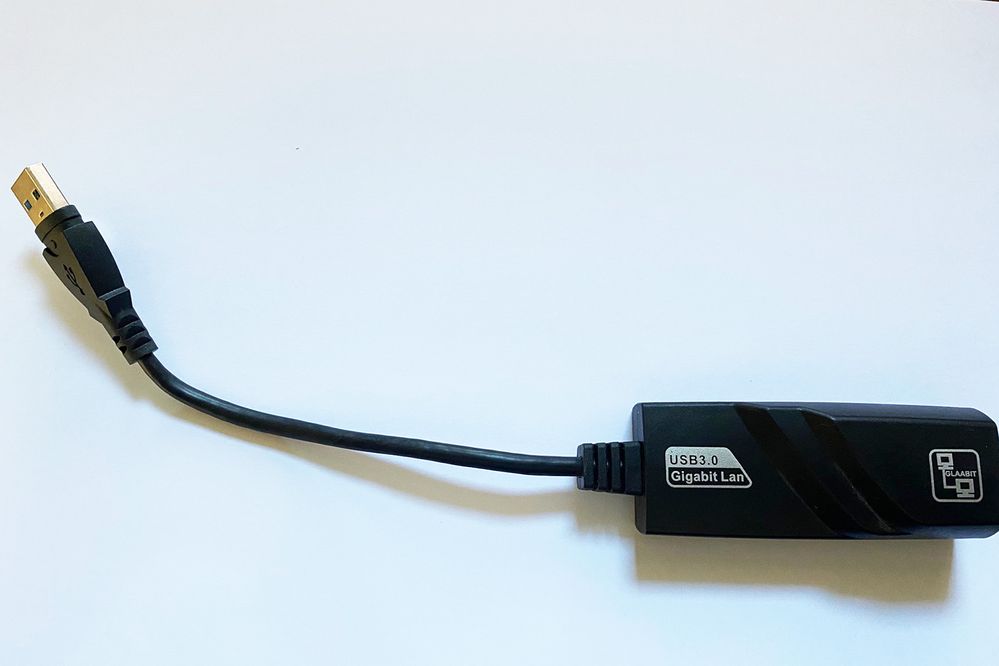

After reading your suggestion I remembered I bought one of these so just tried it for the very first time.
Useless and no good for the 900/110 package at all.
Worst speeds I have ever had since my install. 😞
