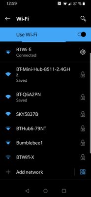

Laptop and phone work fine connected to any other network including the 4g mini hub
Also, out and about my phone connects to bt WiFi hotspots no problem
3,857 Views
Message 59 of 68
Re: Solid Broadband Connection but no Internet/Traffic
Go to solution
Just out of curiosity, does your laptop/phone connect okay to your own BT WiFi hotspot?
3,841 Views
Message 60 of 68
Go to solution
That's interesting....
It connects to someone's BT WiFi but don't think it's my hub which is BT-Q6A2PN which is a full  stronger signal
