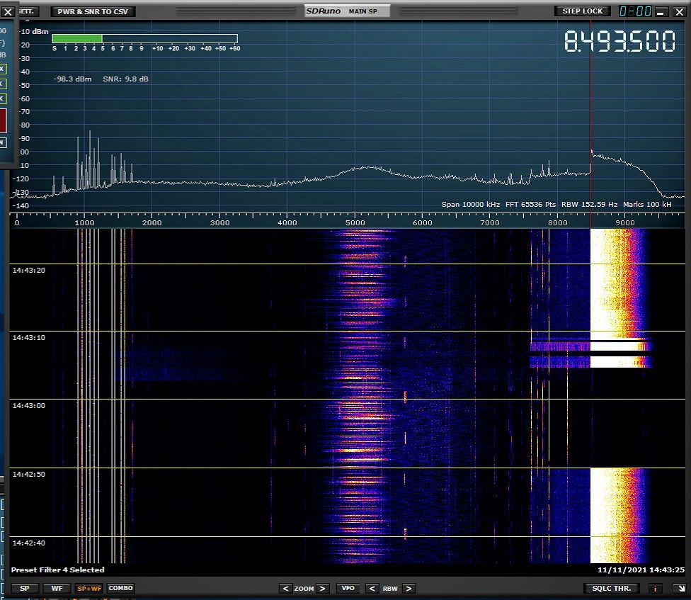

I have a few SDR gadgets so I set one to monitoring the cable from the street into the Hub. I wrapped a few turns of wire round the cable and fed it into one of my SDRs then set it to watch the spectrum from 0 Hz to 10 MHz (which is the widest I can do with this SDR). Not great coupling, and horrible impedance mismatch although I'm hoping that doesn't matter for this purpose. A screen grab of the spectrum and associated waterfall is attached at the end of this message.
The peaks at the low end are (I guess) MW radio stations, and some of the stuff in the middle and at the top I'm guessing is VDSL. (I know almost nothing about VDSL modulation).
And now here's the interesting bit: When the broadband is working properly there's a chunk of spectrum very active starting at approx 8.5 MHz as you can see on the waterfall and the spectrum chart at the top. But when my DSL drops that vanishes for about 15 seconds, and when it does the hub loses its connection. After about 15 seconds it judders a bit and then returns. At which point my hub reconnects and the nice blue light comes on again. So if you look at the waterfall you can see where I lost DSL at 14:42:50, and it came back again when the signal returned at 14:43:10.
Looking at this I suspect 2 things:
  1. The DSL signal from the box in the street died for 15 to 20 secs.
  2. It's not a problem with the cable itself (e.g. something shorting it out on my premises) because the other signals are unchanged.
Any thoughts anyone? And now I have this evidence what can I do with it? Is there any way to get it to anyone at BT who could make sense of it?

As you can see on your last thread, 8.5MHz is the start of the main upload section of the VDSL spectrum, so if you are getting radio interference there, it will cause the connection to drop.
As to the source of that interference, its anybody`s guess. If you are fed from an overhead cable, then it could be picking up spurious signals, but they would have to be quite strong to blot out all of the tone frequencies and result in loss of sync.
I suppose a portable directional receiver capable of monitoring that frequency band may help to locate the source.

But the spectrum snapshot suggests it's not interference doesn't it? When my broadband drops it's because the spectrum at 8.5 MHz drops to zero, so I was guessing its a BT equipment problem. When the 8.5 MHz signal is there the broadband is fine.
It could be a faulty port in the cabinet, but the only way to prove that would be for BT to arrange your connection to be moved to a different port. It depends on how often you are getting the breaks.
