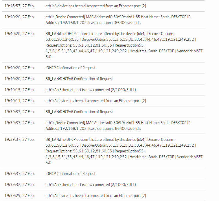

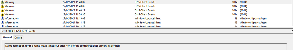

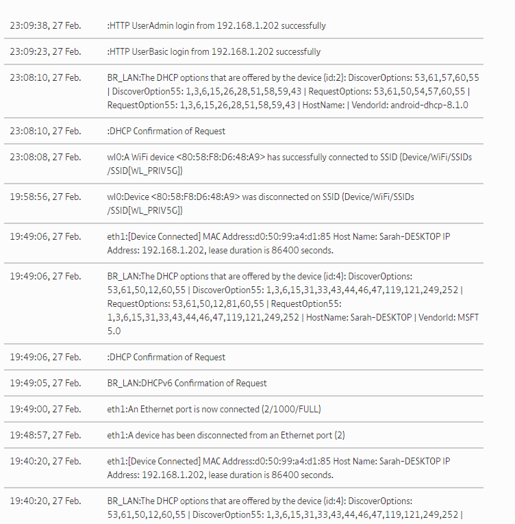

I'll link here the info from the Hub's Technical Logs, and from Windows Event Viewer. Please see attached. Thank you!!
