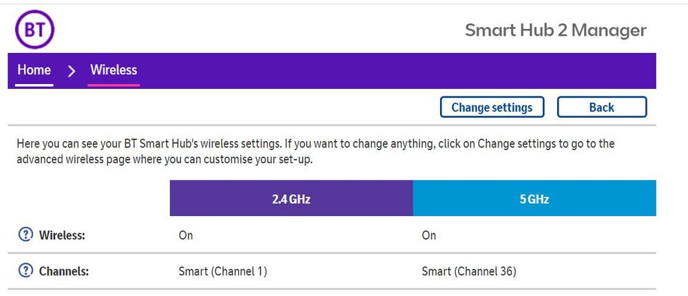

When I say "switch back to..." I mean I have both frequencies available...BT Hub 2 - Advanced - Wireless.JPG

Just a guess try changing the Channels
I use an Epsom XP830 and have had no problem with a BT Smart Hub2
Change Channels/System reset.

Have you also made sure smart set up is set to off in the Smart Hub 2

Hi @Halo64 Changing to wireless mode 2 on your Hub may help but this will also reduce the range and throughput speed on your wifi.

re. turning off "Smart Setup" - yes.

Thanks Neil. Yes, a bit loathe to do that with two teenagers in the house with laptops, tablets, Xbox's etc. (as well as Smart TVs in the house).
Very frustrating - I can't be the only person to have these fairly standard printers and have this issue. The only way it works is turning off the 5.0GHz channel, but again we can't really run all of our multiple devices JUST on 2.4GHz.

The Mods on here can assist if deemed necessary how ever
I would factory reset your BT Smart Hub2  and try again remembering to switch off smart set up again and correcting your passwords if altered.
Then  try and  Change the Channels on your BT Smart Hub 2 starting with the 5GHz then 2GHZ
you can always change them back again
These are things the engineers would get you to  do anyway.

if you factory reset SH2 as suggested by @lifeonmars  then I would also reset your printer and start afresh
