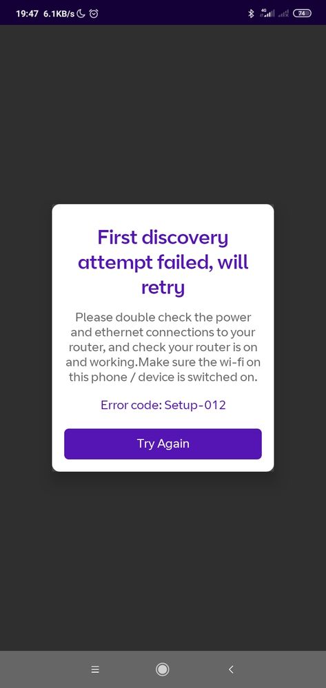

I deleted the app off my phone and went through the sets as per the app guide to set up the disc - unfortunately I couldn't make  a connection. I keep getting an error in the app (image uploaded).
I think the disc keeps dropping every minute or (a lot) less so i can't get the app to proceed.
I tried this process with all 3 discs - none worked. My guess is some dodgy firmware has bricked them all 😞

I also did a clean app install for my re-setup, so you’ve very much done exactly as I did.  I didn’t however receive the message you got.  I’m assuming here that you’ve got the steady blue light on the master disc, and not flashing or red - the disc needs to show steady blue for the app setup to work.  My alternate master disc allowed me to set up using the app, and installing the latest beta forced subsequently added discs to be re-flashed with new firmware too, correcting whatever corruption was present.
If you’ve not already done it, try deleting the Wi-Fi network settings from your phone and re enter or re-scan the disc QR code on the back of the disc.  Possibly clutching at straws here, I know.
A long shot, but, your screenshot looks like Android, I am using iOS, perhaps if you know anyone with an iPhone or iPad it would be worth offering them a coffee and biscuit while trying the app on an alternate platform, just in case your issue is connected to with the version of app in use.  Like I say, this suggestion is a long shot.

First discovery failed is a long time bug in the app. The app is incapable of either
A/ spotting a working mesh and just connecting
Or
B/ moving between networks
As a small business IT pro, this was a deal breaker and I gave up in these a long time ago. I've just been to look and see if the app is updated but no such luck.
