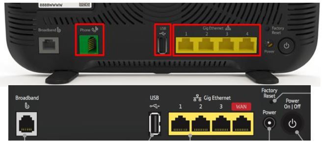

I’m planning my move from FTTC to full FTTP. I’ve noticed that some illustrations of the Smart Hub 2 ports show one labelled WAN with a red label but mine doesn’t. Mine has a green phone port. Will my Port no.4 suffice or will BT need to provide a new router?Smart Hub 2 Ports.JPG

Port 4 is software configurable as a WAN port, so you have the correct one.

if you check in hub manager technical log information you should see switch for FTTP which you can toggle on/off
