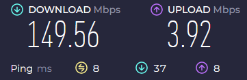

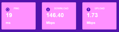

Here's some screenshots of my speeds right now
Speedofme:
Speedtest.net:
Bt Wholesale:
