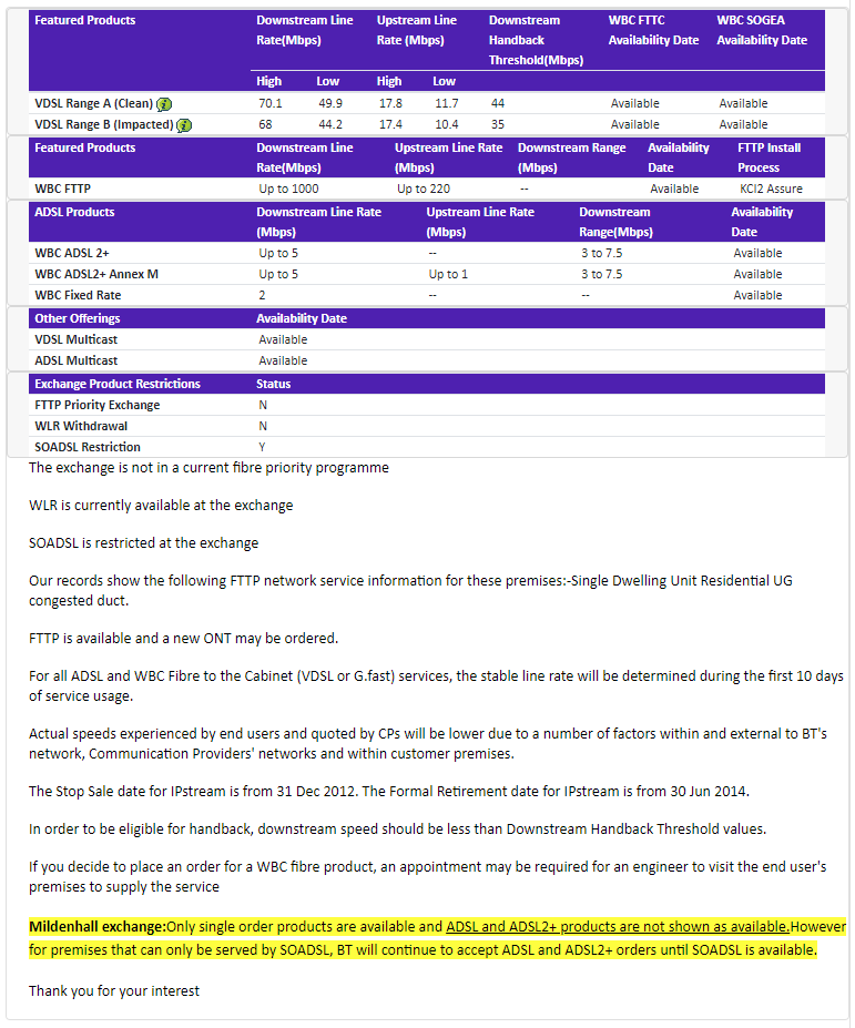

If you are an existing BT customer and the FTTP is an ‘upgrade’ from ADSL or FTTC to FTTP , use your phone number in this DSL checker ( and post the results ) , if not currently a BT customer use the address option ..obscure the phone number /address when posting the result.

Will do! Currently have ADSL with another provider.

From that info it seems you have a congested duct which OR will need to sort out. It is possible they have sorted this out without you knowing but really you would see some evidence ie some fibre cable would have appeared.
All you can do is check with BT.

Presumably you are ordering BT FTTP alongside your existing broadband supplied by someone else , the DSL checker shows KCI2 , and UG congested duct , this should mean once your order is taken , it’s a two stage install , the congested duct may need work , it doesn’t necessarily mean it’s blocked , just that at survey it couldn’t be verified as serviceable.
You shouldn’t be given a contractual date until a cable has been provided from the CBT ( in a joint box somewhere close by ) to your house wall, as obviously it’s unknown what may be needed to get a cable to your property ( and the costs involved ) but the first visit should be arranged to ascertain what’s needed ( if anything )
If you haven’t been given an initial date , and have never seen the 1st stage engineer , you need to ask BT why , if you have had an initial visit , ( possibly confirming the duct as blocked ) it would need work, if the work needed was on your property , then you would have to agree to excavation etc , but you should be kept updated.
Is your property relatively standard ?, there was a post on another forum , not the same issue as you, and not using BT  , but in that case , the CBT was in a public area, but the customers property was some considerable distance away ,(  very long driveway,   hundreds of metres  )  the excavation required was extensive  to get the cable from the CBT to the property ( all within the customer land ) and they were expected to contribute £4K to £8k towards the costs…if your situation is similar it could be there are going to be excess costs , and that in part is responsible for the delay
