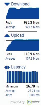

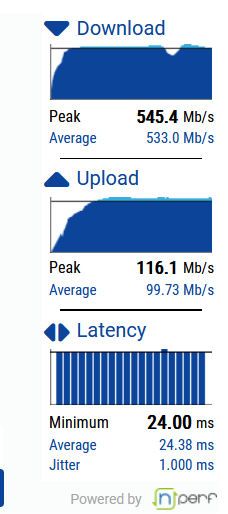

I posted a while back about slow speeds after upgrading from Fibre 500 to 900.  I was averaging 650, minimum guarranteed is 700.  BT monitored for a few days and said they were reporting 900.  I dual-boot Windows and Linux and Linux consistently reports around 900.  We never determined what the problem is so I have been monitoring speed for a few days now and it appears to be getting slower.  Any ideas if this is just a windows thing?  Seems a bit odd that any speed test I use (I've used Fast, Ookla etc.) can't get near the proper speed.

I've used Ookla, BTwholesale, Fast and all show consistently low.

By the looks of this post, they can get full speed on Linux, it's just Windows they are having issues with, possible network driver issue? https://community.bt.com/t5/BT-Fibre-broadband/Full-Fibre-500-to-Full-Fibre-900/m-p/2258536#M341446

In the OP case , they confirm they get the speed they pay for on some equipment/setup and not on another , that pretty much indicates where the issue is.
In your case , provided the profile allocated to you is correct , and the only profile that gets the 100Mb upload is the 900Mb , so that suggests yours is correct, try at a likely quiet time and if the speed is better , perhaps it’s congestion on your PON ( you share 2.4Gb download with others , perhaps they are hammering their connections at the same time you are running speed your tests ) , if there is no difference between quiet times and busy times ( generally taken to be  6-9pm ) then it’s not likely to be congestion.
Fttp doesn’t have any rate adaption, you sync at the speed rate you pay for ( with  the proviso that that has been correctly set by the administrator) throughput is not under your provider control, and WiFi isn’t suitable for any measure of speed , also some people will ‘tests’ although using a wired connection, but using kit  that is not Gb capable or incorrectly set up.
If the router ( SH2 ) is suspect, connect a suitable PC directly to the ONT , set up a PPPoE session with a suitable wired device and run the speed test from there.
