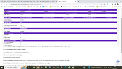

Enter your phone number or your address and post results including all the notes. This will show if available and give indication how FTTP will be provided

I fear that some of the information is repeated as I could only take a screenshot and I had to take two different ones to get all the information. I fear that I cannot understand the information that is there to let me to see how FFTP will be provided. Any interpretation would be helpful.

It says FTTP is available and will be supplied underground and that the route to your house will need to be dug but it is 'soft', i.e garden or lawn rather than hard paving.
