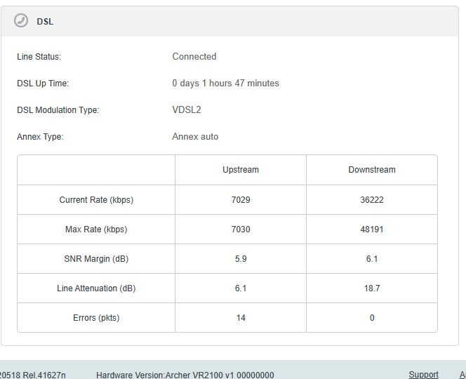

The OR man phoned to say he was on his way this morning, so I turned on my PC and lo and behold my speed was 36mbps, even before he got here, so somebody at BT had tweaked my line, see attached stats. previously SNR Downstream was 13.3 now it's 6.1. How did they do that? The OR guy was chuffed though, he fitted a new wall socket, ran some line tests and was on his way!

someone at BT has done a DLM reset hence why noise margin back to normal 6db and speed back to expected.
just now keep watch in case you start getting drops in connection and the speed problem repeating itself
