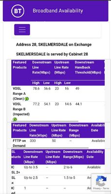

If I use the address checker, it says I can get fibre 2 at 49 to 72Mb, my next door neighbour can only get fibre 1 at 49Mb, and my other neighbour on the opposite side can get fibre 2 at 55 to 72Mb. Yet when I log in to see my broadband upgrade deals, it only shows 49 to 51Mb.

Please post a screenshot of your hub stats and the output of the DSL checker. https://www.broadbandchecker.btwholesale.com/#/ADSL

So the distance between my house and the cabinet hasn't changed, I'm paying for fibre 2, yet the BT website says 49 to 52Mbs, even for fibre 3. Yet I used to get 70s pretty much daily.
Confused.
Also, Gfast is not available to me in my house, yet the cabinet says 330Mbs is available

The 330 isn't G.Fast, it's FTTPoD which is an extremely expensive business product where the full cost of the provision is paid costing thousands

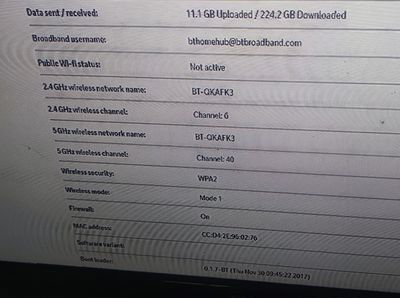

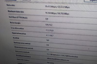

Edit* screenshots instead of the XML file as my son was mid-game 😂

You have cut off the important connection time
