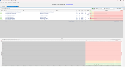

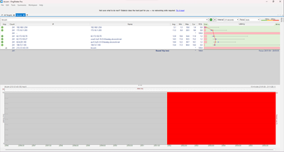

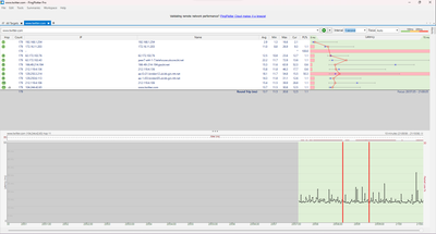

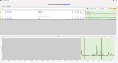

I've ran tests to bt.com and three other servers. I'm not sure how to access to phone line so I have not conducted that test. If it is salient to solving the problem, could you please instruct me on how to access it, so that I can test it.
Here are the PingPlotter results (I'm not able to upload the files):
