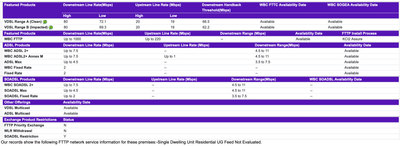

Thanks for your help.
So this is the result on my property:

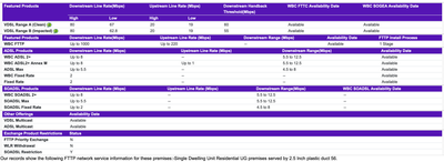

This is for one of my neighbours in an equivalent flat to mine across the car park. It's quite difficult to explain, but the mews has 2 buildings, both identical. Each has 12 properties, 3 flats in a block, then 6 houses, then 3 flats. All were built together in 2017.

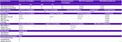

This is the result for the house that is directly connected to the block of my 3 flats:
I've checked other blocks on the new build estate that are behind ours and they are showing FTTP as available to order. I contacted our management company and they also say that FTTP should be available. I've gone back to Openreach again asking them to double-check. We had issues with our postcode when I first bought the flat in 2017 as a new build, whereas neighbouring postcodes could be found, but ours couldn't. I wonder if that has anything to do with it as well.

Your address has no FTTP survey entry , this is the case for every address that hasn’t been surveyed for FTTP and the PON built for that area, some addresses will be extremely close to others that have FTTP availability, but happen to be on the wrong  side of the PON boundary, it’s not unusual for one side of a road to have access to FTTP and house’s directly opposite not to have access, it’s just where the boundary was drawn, PON boundaries tend to be along  a ‘natural’  boundary, but occasionally next door neighbours , one could have access to FTTP and the other doesn’t.
The survey return you provided, the ‘house’ has the expected survey return for a house with a ducted feed  ( Single Dwelling Unit , Residential UG served 2.5inch duct ) , Apartments depending on the number of ‘units’ are normally are defined as MDU , Multiple Dwelling Unit , so it could  be the other apartments are incorrectly recorded as SDU and should someone order FTTP for one of them  , Openreach could have an issue in providing service, and the order would fail, or it could be that the apartments  are correctly recorded,  smaller apartment complexes , less than 6 units , can be considered as SDU  if the existing copper service is directly ducted ( so not a common internal distribution point ) and the same method can be used to provide FTTP, because there will be no issues with permits etc, just like ducted houses.
Your set of apartments has no survey note, it could be because of the addressing issue you encountered previously, or it could be simply that you unfortunately are the wrong side of the PON boundary , however if it were the case that the address was the issue , when you contacted OR that error should have been picked up and corrected, allowing you to order, the likelihood is that although close by , your address isn’t within the PON area that has been built , that does cover the other (mirror image) apartments.
