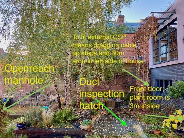

I think the question I am really asking is: can OR  fit the CSP (Customer Service Point / customer splice point or whichever acronym OR is using ATM) inside the plant room?
The motivation is that I want to avoid:
  1. putting an ugly CSP on the rather nice brickwork on the front of the house (we built it, my wife's the architect, it's won awards)
  2. long lengths of cable snaking around the house (again, ugly, so we'd need to fit conduit if this was needed).
I believe this is possible, although not certain (for example, see this thread).
The counter argument is that, AIUI. external fibre can generate toxic fumes in a fire, so OR engineers can only run a couple of meters internally. However, this would be ample - see the photo below. In addition the outer sheathing could be stripped back (see this thread).

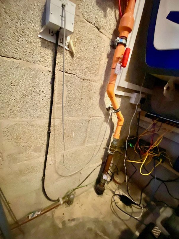

Currently the copper comes in from the BT man hole via a wide plastic plumbers pipe so there is likely to be room to bring fibre in too.  The pipe is the usual red-brown colour, in the corner of the floor, with the black cable emerging from the foam.
There is plenty of space on the wall to replace the master socket with an ONT as well as fitting the CSP with a fairly straight run of internal fibre - or so it seems to me, but I am not a telecoms engineer.
I suspect fitting a CSP externally on the front, or on the back, will be more work for OR than feeding it through the duct into the plant room. They'd need to drag it through the duct from the OR manhole in the front garden, trail a cable from the duct and then drag it 30m round the house, past 3 or 4 sharp 90 degree turns.
I therefore suspect that fitting the CSP may be possible - as long as I am around when OR does the first visit. If they come and do the external work without an appointment and fit a CSP on the front brickwork, that will be bad!

First and foremost, we've been pulling through the existing ducts and replacing the old copper boxes with the CSP. Congested or not, the goal is still the same as above. So in summary we're already looking for the easiest solutions early on if the customer has no specific requests. Couldn't guarantee it but an engineer would likely want to fit the CSP in the plant room anyway.
I've done CSPs in internal garages due to this. Can't see this being that much different. I'd look at this and the simplest option would be to use the duct in place, cleat the fibre along to the master socket and fit the CSP there. I don't disconnect copper however so I've been fitting them parallel to the master socket. If your appointment is the entire process in a single go, I can't see an issue with removing the master socket and placing the CSP in its place.
If you want it neat and tidy, get the CSP fitted directly above the duct, capping and all.

Quick update. Today, some considerable time after BT thought would be possible, I had a visit from an Openreach engineer to do a survey.
They were excellent. Knew exactly what they were doing, and had tested feeding cable through from the Openreach plate at the front before he came in.
He then tried from the plant room and found as expected there was the anti-rat / water blocking material in the duct. But he was able to prove to his satisfaction that he'd be able to get the cable through, he'd just need to bring some more blocking material. And he was happy to fit the CSP internally.
He's planning to come back on Monday to do the job, then BT can do the fibre install.
Looks good so far!

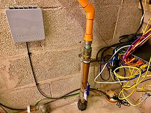

So, Openreach promised to come back on Monday to finish the install, but actually came back Friday 😁, which was great.
Two engineers came in and it took them a while due to an angle on the duct that was a bit sharper than was convenient. However, as they pointed out, they have ways of dealing with these kinds of issues and they got thew job finished in a few hours. I was very impressed.
There is an issue, in that the CSP in the BT box at the front of the house isn't lighting up, but they think that can easily be fixed.
So all looks good for now and I have a neat fibre install in my plant room waiting to be connected up 🙂
