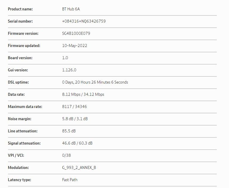

You really need to post the connection stats from your SmartHub as that might give us an indication as to what is going on.

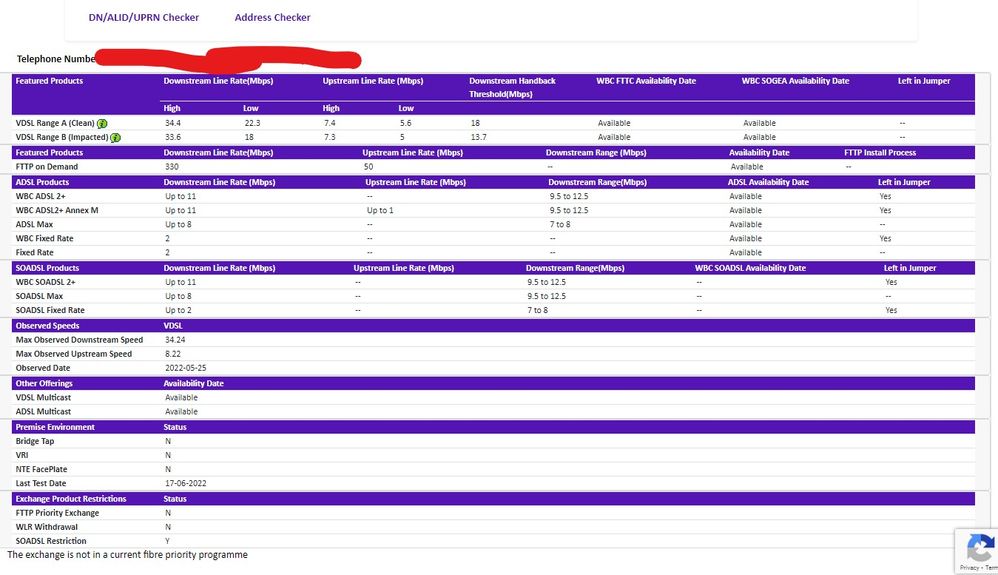

OK, is this any help?  I am not that tech savvy!Screenshot 2022-06-22 183803.jpgScreenshot 2022-06-22 183905.jpg

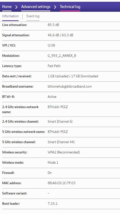

You've missed off the important information from the top of the hub information page. Could you post that please.
You are never going to get fibre2 speeds.

From dslchecker results your expected speed range is 34/22 mb so anywhere inbetween. As I posted already you cannot get fibre 1 max speed of 55mb so no point wasting money on fibre 2

Sorry @licquorice didn't realise it had scrolledScreenshot 2022-06-22 193000.jpg

From your stats, you are getting the absolute maximum your line will support as evidenced by the noise margin figure of 3.1dB. It is also at the top end of the checker predicted speeds.
Unfortunately, you are a victim of distance from the cabinet.
