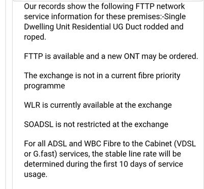

Enter your address and post results including all the notes. This will show what is available and also if fibre available how  openreach expect to install cable

 Does this help

‘duct rodded and roped’ suggests the duct may have already been verified as usable, is there a rope sticking out of the grey plastic cover over the duct (against the house wall)  as the survey note suggests ?, if so the duct may be fine .
