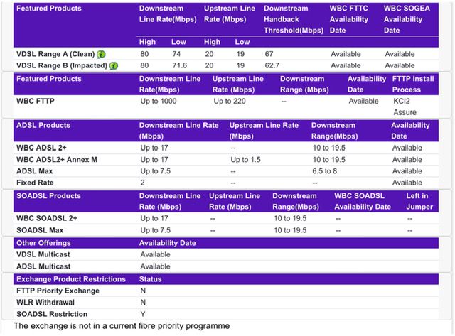

Ok. I have checked the BT Broadband Checker and this is the result for my address. I assume that ‘WBC FTTP’ (Ultrafast FTTP) is the important line re availability at my house? 349247E7-0C8F-4E56-B9F4-C7B3980B6F0F.jpeg

Go to solution
That does indeed show that OR FTTP is available KCI2 ( keeping customers informed ) 2 presumably the origin of the ‘2 stage’ install , on the same site , below the info posted is normally a ‘line’ that displays the survey return for the address ,something like  ‘ UG built to curtilage, hard’ is what I would expect given your description of the area your property is in….you could  find , if a single ‘toby box’ can be positioned to serve two property’s,  it could be in the footpath but on the boundary line  between two addresses ( like a pair of semi detached for example )

This is the relevant info below the table?
Our records show the following FTTP network service information for these premises:-Single Dwelling Unit Residential UG congested duct.
FTTP is available and a new ONT may be ordered.

That is indeed the part , it shows that you do have an existing duct ( so at a guess your property was probably built in the 1990’s or later ) but it wasn’t possible to verify that the duct is serviceable, hence the congested duct survey note , ( so no general area excavation to build toby boxes ) you get a two stage install because it’s possible the duct may need ‘work’.
….a typical scenario could be a porch has been built on the front of the property , it is in line with where the duct should appear, if the neighbours houses are of similar design, it may be possible to ‘see’ where their duct comes up on the wall ( grey plastic covers ) and presume your duct should  appear at the same place.
Basically the OR cablers will attempt to locate and cable the duct to the location of the CBT , if successful they allow the second stage ( also Openreach ) to continue and finish the install ( CSP /ONT etc ) , if the existing duct cannot cabled on the 1 stage visit and ‘extra’ work is needed , they discuss with you what you are prepared to have done , for example if the point at which the existing duct needed  excavation was under a concrete drive you may say ‘No’ and then the  order is cancelled with no compensation, as you refused to allow the work .
If happy with what’s needed , ( assuming work is needed ) the 1st stage continues with the excavation , that may need extra civils workers and a new 1st stage date,  ( so you still haven’t been given a contractual date yet  ) when that ‘civils’ work is done , and the optical cable exists between your house wall and CBT , the second ( contractual date ) stage is started.
TBH , so far your ‘journey’ has been correct, you were told a two stage , so basically not to get too ‘excited’ as extra work may be needed, it’s always possible that the existing duct isn’t congested, and can be cabled on the first visit , and the ‘expected’ 2nd stage dates are used, obviously if ‘work’ is needed the second stage date is changed to reflect what ever work is needed.
