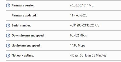

Thanks to a mod here I am now getting the most out of my connection (still only FTTC), so hopefully they can assist you:
New speed

Hi @MartinR34, thanks for taking the time to speak with me on Wednesday. I've got a colleague now to request your profile is corrected to 55/10. This should be completed shortly so please check your connection over the weekend and let me know how you get on.

Thanks very much for this.  Yes, we are now receiving higher speeds at the hub and no longer appear to be capped at 40.
