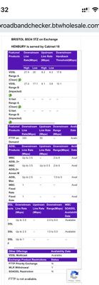

What does this checker show for your address ( post the results )
https://www.broadbandchecker.btwholesale.com/#/ADSL/AddressHome
