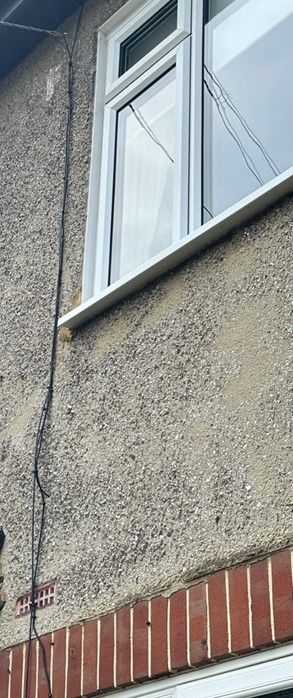

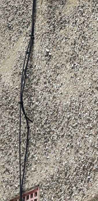

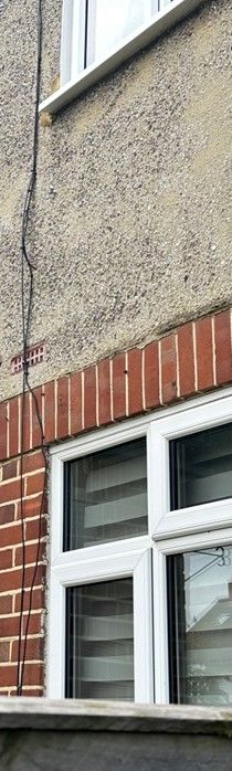

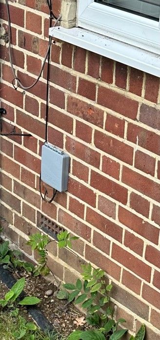

My FTTP was also installed around a similar time and I too have an internal CSP. I live in a 1st floor maisonette. My ground floor neighbour also has FTTP and they have an external CSP. I'm guessing the internal CSP is far less common than the external one. I've attached pictures which show what Openreach did at the time of installation. Our installs were done by different engineers and mine was done around 3/4 months before my neighbour.Where the fibre enters my property and goes into an internal CSPWhere the fibre enters my property and goes into an internal CSPCloser inspection viewCloser inspection viewNeigbours fibreNeigbours fibreNeighbours external CSPNeighbours external CSP
