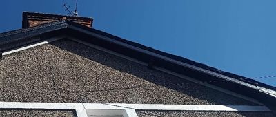

All they had to do was pull the fibre through the wall into the hole they drilled.  Simple, only a person of low intelligence couldn't understand that.
And yes, I've worked with fibre for 20 years.  I've common sense which you clearly don't have.

All they had to do was pull the fibre through the wall into the hole they drilled.  Simple, only a person of low intelligence couldn't understand that. And where exactly would the EXTERNAL csp go then, on your skirting boards?
And yes, I've worked with fibre for 20 years. Yet  you dont know that openreach et al, have to install a csp external at ground level, perhaps you need a refresher course .
I've common sense which you clearly don't have. Err no, there are rules and procedures to follow,  which have been followed on your install,  if you dont like it, cancel and get a non openreach fibre provider to connect you up.

None of what anyone has said will get around the obvious route which would provide the best and tidiest service.  Fewer joints = less chance of failure and less loss.

None of what anyone has said will get around the obvious route which would provide the best and tidiest service.  Fewer joints = less chance of failure and less loss. Doesn't matter what you think, the lead-in is not suitable for use internally, as can give off smoke/fumes in a fire, thats why a eazybend fibre is run from the csp to the ont, which is why there are standards and rules to follow. Also a correctly done splice doesn't lose light, how do you think it can run for miles, but you should know that.

I spoke to BT who agreed it was unacceptable and have lodged  complaint with Openreach to return and tidy up the cabling.  I certainly won't be recommending Openreach to anyone and have passed these photos on to plenty of others, who all had a good laugh at what they considered ok.

Do post a picture after they have been.

Great job second time around, done the way I'd have expected it to be done originally.
