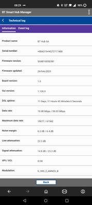

1. You haven't had a DLM reset, your DSL uptime is 11 days.
2. A DLM reset will only give you a tiny increase in speed if at all looking at your line stats.
3. I wonder if, when your line was replaced, it was connected leg and leg. I.e one wire from one pair and one wire from a different pair rather than a true pair.

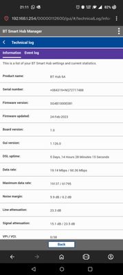

Any ideas if the reset went through? The modem seemed to have restarted about 5 days ago but no change in sync or stats.
Thanks
2,891 Views
Message 18 of 19
Re: Replaced line, lower sync speeds
Your connection reset 5 days ago with marginal increase in speed but with similar attainable speed. Looks like as good as it gets
