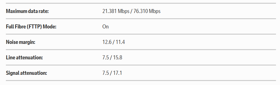

Ok, using the BTHomehub here's a screenshot of the noise stats - and the others around it.
4,668 Views
Message 12 of 27
Re: Returning to BT from Sky - why are my connection speeds now limited?
Go to solution
You haven't shown the actual speed, it's the line above the first line of your screenshot. However, the max data rate and noise margins indicate you are on the wrong profile.
Call customer services and get them to realise your line is misconfigured.
Post back if you get no sense from them and we can get the mods involved.

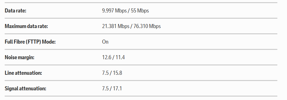

Apologies - here it is with the additional line:
4,638 Views
Message 14 of 27
Go to solution
That definitely confirms fibre1 profile.

@Haggini
Well that's a Fibre 1 profile not Fibre 2.
Assuming  you actually ordered Fibre 2 then you've been put on the wrong profile and your line is certainly capable of attaining maximum Fibre 2 speeds as you had with Sky.
