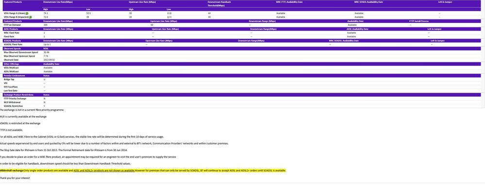

OK there we go, that first attempt had my phone number on it lol

there are no estimated stats shown on the dslchecker   can you try again as there should be speed ranges shown for your connection.  as I said you are obviously further from street cabinet than you were in previous home hence the drop in speed.  there is nothing you can do about that
if you still for whatever reason don't get expected speed ranges then try your address

that shows a speed range of 74/52mb far faster than you are getting even your attainable is nowhere near that.  are you connected to the master socket?  have you tried using the test socket with a filter to see if that helps
is there any line noise  dial 17070 option 2 should be silent and best with corded phone
